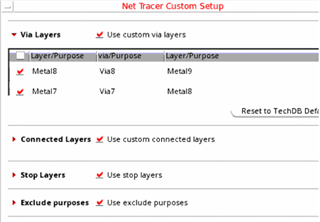

I see in documentation that Net tracer have a custom layer setup form like in the first image. But in my Virtuoso (ICADVM18.1-64b), I dont see any such form. Is there any skill way to invoke this form?
Which version of Virtuoso which supports customizing the net tracer connectivity?
Also the net tracer options form is different form the documentation.
Documentation:
vs My Virtuoso:
-Ramakrishnan

    Anyway, you need to change the cyclic choice on the Connection Setup from the name of a constraint group to "Custom" and then the "Setup..." button will be ungreyed and when you click that, you'll get a similar UI to what you've seen in the documentation.
