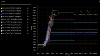

Hi, I'm trying to create several plots in succession and save them to files automatically. Running into trouble with saveGraphImage()
win0 = awvCreatePlotWindow()
awvPlotWaveform(win0 vtuneL ?expr cornerL)
awvDisplaySubwindowTitle(win0 "vtune")
awvSetLegendWidth(win0 400)
saveGraphImage(?fileName "~/Images/vtune.png" ?width 1280 ?height 720)
If I run this, the file is created but the waveforms are "undersampled", as though only 1 out of every 100 points were actually used to draw the line. The graph that pops up in ViVa looks nice and smooth, and if I run the exact same saveGraphImage() command again from the CIW, it produces a file with smooth waveforms.
Now, I tried placing the saveGraphImage() call into a hiRegTimer, and this fixed the issue for a single case. When I add another plot though, only the last one gets saved "smoothly", the first becomes coarse again no matter what I tried.
Running ICADVM 18.1-64b.500.11
Thanks in advance!

    YiWang over 6 years ago in reply to Andrew Beckett
    Hi Andrew and smikes
    On top of using hiRegTimer, I have added hiFlush() between the awvLoadWindow and saveGraphImage, then it works.
    In the hiRegTimer I waited for 2 seconds
      when(awvLoadWindow(vivaWin, grfFile, ?resultsDir resultsDir)
        vivaWin = awvGetCurrentWindow()
        awvDisplayTitle(vivaWin windowTitle)
        hiFlush()
        when(isPrint
          saveImageCmd = sprintf(nil "saveGraphImage( ?window car(setof(x awvGetWindowList() x->wsId == \"%s\")) ?fileName \"%s\" ?width %d ?height %d ?backgroundColor  'white)" vivaWin->wsId imageName width height)
          hiRegTimer(saveImageCmd 20)
        );when
      );when
