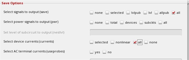

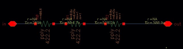

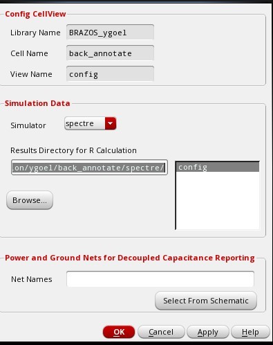

I have been trying to backannotate "my_cell" with effective R value. "my_cell" is schematic with series of 3 resistors and two pins "in" and "out". I made a config view TB using av_extracted_RC(using PVS-Quantus) view of "my_cell" and ran a dc simulation with DC input of 1.2V at "in" pin. I have kept "Save DC Operating Point"  enabled and saving all voltage and current nodes from the Output options in ADEL. After simulation ended I descend into schematic view of "my_cell"(out of context). Then I go to Parasitics->Setup which already had result directory correctly filled under "Results directory for R calculation". When I go for "show parasitics"  option, it gives me capacitance values of each net but R is shown as "NA". Can you help me with where am I going wrong?

    I think the issue may be because the presistor has been netlisted as a subckt. I would suggest that you set the view list in your config to have spectre before schematic (normally the default) or at the…
    I think the issue may be because the presistor has been netlisted as a subckt. I would suggest that you set the view list in your config to have spectre before schematic (normally the default) or at the very least to pick spectre as the View to Use for the presistor.
    Can you try that? You'll need to re-simulate of course.

    Yes it worked! It is just presistor which has schematic view. Others like pcapacitor doesn't have schematic view hence it was using spectre view. So capacitance was getting reported but not resistance. It makes sense. Thank you!
    Andrew Beckett over 5 years ago in reply to Ymmen
    The capacitors are shown directly anyway as they can just be summed; to find the effective equivalent resistance needs a solver, which is why simulation is used to find that information.
    Anyway, glad that fixed it!
