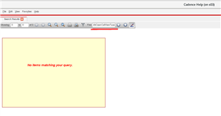

Recently,I need to create the pcell using skill in virtuoso.
I want to know where I can understand these function,eg:dbOpenCellViewByType,dbCreateParamInst.
I have queried many docments,eg:SKILL Language Usere Guide,SKILL Language Reference.but its useless.
I also try to open 'the skill finder' from virtuoso,but its no response,maybe my cadence is not intact.
And,I find that maybe the doc 'Design Framework IITm SKILL Functions' is useful for me.But i don't find it.
Thanks for your help.
    You didn't mention the version of the tools you're using, but since IC617 at least you could either search from the Help menu (enter the function name, then it will bring up cdnshelp with the matches) - the blue annotation below, or you could launch cdsFinder from the command line, search and hit the More Info button (which would bring up the help page for that function - I didn't show that part) - the red annotation below:
    Alternatively, in the CIW type cdsGetInstPath() which will tell where your software installation is, and other that, look in the doc/skdfref/skdfref.pdf - for example:
    /export/home/apps/IC618_isr/doc/skdfref/skdfref.pdf
    Or look on support.cadence.com - you can search in the documentation and this would lead to (say) dbOpenCellViewByType documentation (note, I can't guarantee this link will work forever as it points to a specific version of the documentation). Make sure you don't pick the "Integrators Toolkit" documentation because that's talking about the C interface rather than the SKILL interface.
    So there are numerous ways of getting to the documentation - hopefully one of these will save you.

    Sorry,I forget to show my version 617.At the very begining,I try to search my unknowing function from "Cadence Helper".But it always show "No items matching your query"
    I find that my cadence lack the file "cdsFinder" by opening the"Skill API Finder"

    Andrew Beckett over 5 years ago in reply to Azraelqq
    That's the wrong place to search in cdnshelp - that will only search within the page. You have to use (I think - I'm not on the network so can't check with IC617 right now) View->Navigator and search from there.
    The functions in the User Interface SKILL functions are nothing you would use in a PCell, so this seems a bit of a mix of questions - it's pretty unclear as to what you're trying to find out.
    cdsFinder should be found in <ICinstDir>/tools/bin - if it's not there, somebody has messed with your installation and you should request that a new, clean installation is performed.
