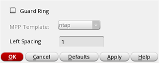

Hello everyone:
   In   IC618.  I am having trouble making a skill tool menu。

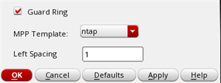

When creating a button using the hiCreateBooleanButton() function,
When Guard Ring is selected, the following two items can be edited,As shown below:
When the Guard Ring is cancelled, the following two items cannot be edited,As shown below:
I know I need to modify the ?editable value, but I don't know how to connect them.

    Jen,
    You can do this via a callback on the button_ring field. See the modified code below:

    procedure(rkMatchFormGuardRingCB(form)
        let((ring)
            ring=form->button_ring->value
            hiSetFieldEnabled(form->guard_ring ring)
            hiSetFieldEnabled(form->space_left ring)

    yankunRen over 5 years ago in reply to Andrew Beckett
    Thank you very much,Andrew
    According to your method, I realized this function, thank you
