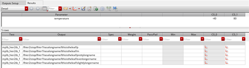

Hello all.
When inspecting the outputs in the Maestro "Results" tab, the output, if nameless (which are most of them), shows the full hierarchical pathname of the signals.
However, if 1-2 hierarchies levels exist, then the text is only partially shown. One can adjust the width, after every run, but it is a bit annoying.
Is there a way to make the width to automatically adjust.to the text's length?
Happy holidays, and a happy, safe, healthy new year.

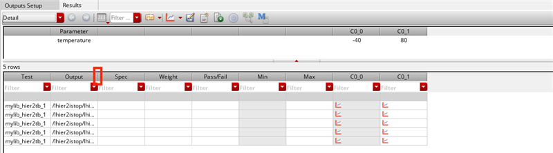

    There's nothing to resize automatically after each simulation (CCR 1006667 and numerous duplicates is asking for this - you might want to contact customer support and request a duplicate be filed on your behalf).
    If you double-click on the splitter to the right of the column, then it will resize to fit, but it's something you have to do manually each time (which is a pain, I agree):
    Double clicking in the highlighted region ends up like this:
