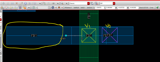

    Hi Andrew, i have a doubt similar to the above code  but here  i need to highlight the extra portion of passing metal through Via. as i shown in the below image . . in this case i don't need to change the via enclosures. need to check left and Right sides of the V1 for extra M1.(metal1)  if it's touch V0 or V1  we can ignore. those extra Metal.  Thanks in advance.
    Andrew Beckett over 5 years ago in reply to VKkumar
    That's a completely different requirement that has very little to do with the code above. The requirements aren't that clear to me, but to be honest I'm not going to have the time to help with this in the next week or two anyway. So I suggest that you contact customer support.
