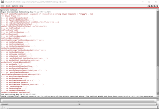

Hi all,
While I try to run the simulation, virtuoso window appears below error messages(black box).
I have checked all the schematic parameters, they looks fine though.
Can somebody help me to figure out what is going on.
Error message:
Thanks in advance.
    I've not seen any reports of this error in general, so I suspect it's something to do with a custom netlisting procedure or something in your environment. This is best handled via customer support, but as a first step, perhaps you can do:
    _stacktrace=40
    and see if it provides more detail when the errors occur. If not, try also setting:
    sstatus(errsetTrace t)
    and trying again. It may give more fo a clue from where this is breaking.

    Hi Andrew,
    I try to type these two command in the CIW and run it again.
    And the CIW pops up the following errors. But I have no idea what this is.
    Can you give me your suggestions?
    Many thanks.
    Sincerely
    Daniel
    Andrew Beckett over 4 years ago in reply to Danielrayray
    Hi Daniel,
    OK, that looks like a bug in the netlist procedure for one of the devices in your PDK (SpectreMOSNetlistPro is not a Cadence function). Probably you need to contact the foundry. Which foundry/process/PDK (and PDK version number) are you using?
    Daniel,
    I wouldn’t be expecting a custom netlist procedure to be calling almGetParameterList, so something is definitely a bit unusual in the implementation.
    Hope they can resolve it once you’ve reported it!
    Hi Daniel,
    It's not the model files or ".tf" file that's the issue here. The PDK has declared in the CDF (in the simulation information for one fo the MOS devices, presumably) that they are using a custom netlist procedure, SpectreMOSNetlistPro, and that function is defined somewhere - probably in a SKILL file (either normal or encrypted) or a SKILL context file (.cxt) that is loaded when the PDK is used (maybe via the libInit.il file in the technology library or library containing this MOS device). That function is calling almGetParameterList - and the failure is happening because of that (I don't know what that code is doing, or why they think they need to call almGetParameterList).
    Are you saying that if you switch back to the old version of the PDK, it's OK? If so, presumably something changed between the two implementations; either they didn't have a custom netlist procedure, or the implementation of that procedure changed.
