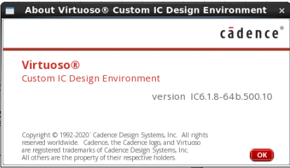

Hi all.
In current environment I have variable that depends on other variables as formula:
Is there a way to loop over variables and print them as formulas instead of calculated values?
Thank You in advance.

    axlGetVars(sdb) returns (0 nil)
    Andrew Beckett over 5 years ago in reply to dragank
    I can't imagine how this is failing - sdb must be valid because it would have given an error if an invalid session was provided. Your picture showed there were clearly global variables, but even if there were no global variables it would not return 0 as the first entry in the list.
    Is this ADE XL or Explorer/Assembler? Which IC sub-version are you using?
  • dragank
    dragank over 5 years ago in reply to Andrew Beckett
    It is ADE Assembler.
    The only thing that makes any sense is if the first argument to axlGetVars() is not a handle to the root of the SDB data structure. If it's a handle to a different node in the SDB data that doesn't have a vars object, then that's the only reason you would get (0 nil).
    Are you using my code as-is, or are you doing something else? If you do:
    sdb=axlGetMainSetupDB(axlGetWindowSession())
    what do you get?
    Then: axlGetTests(sdb) and axlGetVars(sdb)
    These APIs have been stable and reliable for years (since ADE XL existed), and I've never come across a case where they don't work, other than usage issues. So I'm sure it's not a version issue in this case (I checked in the version you're using, plus I checked to see if there were any records of similar issues - which there never have been as far as I can see).
  • dragank
    I tried both approaches.
    First I included your function.
    Then I used it as a guideline to make new one.
    Sequence of variable resolutions is:
    winSession = axlGetWindowSession() ; "fnxSession0"
    x_mainSDB=axlGetMainSetupDB(winSession ) ; 1001
    axlGetTests(x_mainSDB) ; (1040 ("sim_test_mos3"))
    axlGetVars(x_mainSDB) ; (0 nil)
    Function that makes error is:
    defun( getGlobalVariableValues (sess)
      let( (output)
        output = list()
        x_mainSDB=axlGetMainSetupDB(sess)
        vars = axlGetVars(x_mainSDB)
        foreach( varName vars
          var = axlGetVar(sdb varName)
          output = append1(output var)
       output
    I've just tested the four lines above with a brand new Assembler session, where I added a test but didn't yet add any global variables. In that case, I have (0 nil) returned. As soon as I add a global variable, then it starts returning something:
    (1053
      ("a")
    for example.
    Your function also won't work properly (assuming axlGetVars is behaving) because your axlGetVar within the foreach loop is using a variable sdb rather than x_mainSDB.
    Other than that, I cannot see any mechanism for this to be returning (0 nil). If you genuinely have global variables, you'll need to contact customer support - I cannot see how this would fail.
