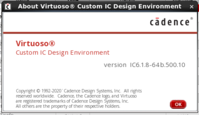

    The best would be if I can check if history was Monte Carli simulation,
    I am using maestro.
    Cadence version
    Dragan
