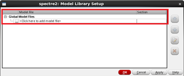

I'm writing SKILL code to add same interface of "Model Library Setup" in ADE to my customized GUI form. For example, to replace red frame part of attached picture-2 interface with picture-1 red frame part.
Also, I have question about how the editable pull-down menu of "Model Library Setup" works, how does the program get the choices of sections? By searching through keywords of "section" in the model library file?
Thanks,
Meng
picture-1
picture-2, replace with picture-1 red frame part.
    Hi Meng,
    You can't. This is a custom widget that there's no public interface for. Similarly the behaviour of how it offers the list of choices for the section is private too (it's built into the private widget).
