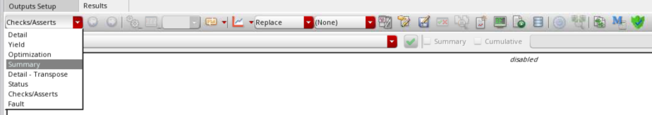

Dear all.
I am using IC6.1.8-64b.500.10
I have added assert file to the model libraries and I am running simulation which produces results but when I switch to Checks/Asserts I see that they are disabled.
Is there a way to enable them?
Best regards,
Dragan
  • dragank
    dragank over 5 years ago
    The only way I found so far was to add .scs file with asserts to Model files of corner:
    There is no difference if Checks/Asserts are enabled or disabled:
    Andrew Beckett over 5 years ago in reply to dragank
    This is to be expected. It's nothing to do with the fact that the file contains asserts - if you add files using the model libraries on the test, and then have model files defined in corners, the model libraries from the test are replaced with the model files from the corner. If you don't want to add the file containing asserts to every corner, you could add to the test as a Definition File on the Setup->Simulation Files form. These files are kept regardless of whether corners are enabled or not.
    The reason this happens if that if you are using models from corners, you want them to replace the model files from the test, and the tool has no way of knowing which files you want replaced and which you don't - so it replaces the lot.
    dragank said:
    I already asked question on that subject and adding files to test is working, but adding to definition files is not.
    If it's the thread I'm thinking of, I did give an answer a few weeks ago.
