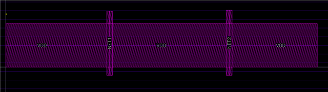

I hope other nets will be opened and wiring will be done automatically. Is there a script or technique that fits this?
chanho
chanho over 5 years ago

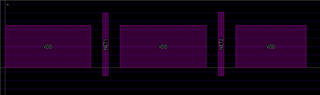

Is there a technology that doesn't work like the picture on the left and automatically works like the picture on the right?
    It's not entirely clear what you're expecting here - but if you are wanting to draw what's on the left, and then have it chop the horizontal track into pieces around any crossing track on a different net, then there's nothing built in as far as I know. It could be written with SKILL - below is a rough outline of how this could be done (note that this is using dbLayerAndNot to generate the new shape rather than leChopShape which would preserve the pathSegs - but that was more complex as you would then potentially have a growing number of shapes as each chop was done - I decided that I couldn't spend that long on an unclear requirement). Anyway hopefully this will give you some ideas as to how you could do this or something like it in SKILL:

    I meant to say, to use this, select the VDD track, and then use:
    CCFchopAroundCrossingNets(0.2) ; or whatever distance you want to allow around each crossing track. It only chops around crossing tracks that are on different nets.

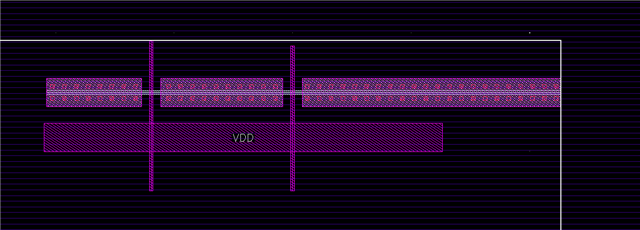

    cellname =cksgh
    It refers to an instance called csf in a cell called cksgh. Sorry for my bad English.
    Andrew Beckett over 5 years ago in reply to chanho
    No, the code I wrote was just an example - it won't edit shapes within the cell (can't you do an edit-in-place first and then use the SKILL code?).

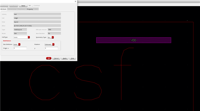

  • chanho
    chanho over 5 years ago in reply to Andrew Beckett
    I want to use the SKILL code including the information of the subcells.
    As shown in the picture, you can't cut it because you can't see the net information of the lower cells.
    That picture doesn't help clarify anything, but it's more to do with the fact that you can't select the VDD track in the lower level cell instance because you can only select things in the cell being edited not lower down in the hierarchy.
    Either way, the code is an example - if you want it to start traversing the hierarchy and looking for lower level shapes to edit, you'll need to make that change yourself.

     Overlaps=dbShapeQuery(cv object~>lpp object~>bBox 0 32)
    sub-PCell을 인식하고 수행하는 방법을 연구하고 있습니다. 레이어를 인식하지만 dbLayerAnd에는 반영되지 않는 것 같습니다. 왜 그런지 아세요?
    procedure(ChopAroundCrossingNets(chopDistance @optional (objects geGetSelSet()))
    let((overlaps cv (tempLayer "y0") anded grown choppedShapes)
    foreach(mapcan object objects
    cv=object~>cellView
    inst=cv~>instnaces
    overlaps=dbShapeQuery(cv object~>lpp object~>bBox 0 32 inst~>trnasform )
    overlaps=setof(overlap overlaps overlap~>net!=object~>net)
    anded=dbLayerAnd(cv tempLayer overlaps list(object))
    grown=dbLayerSize(cv tempLayer anded chopDistance)
    choppedShapes=dbLayerAndNot(cv object~>lpp list(object) grown)
    choppedShapes~>net=object~>net
    choppedShapes~>lxStickyNet=t
    choppedShapes
    Andrew Beckett over 4 years ago in reply to chanho
    You seem to have edited the post above and changed it to include the description in Korean - probably not very likely to get an answer that way. Also, the code has got several mistakes in it (e.g.cv~>instnaces and inst~>trnasform. Either way, the result from dbShapeQuery will give you a list of shapes if you've specified 0 as the stop level, but with 32, each found shape will be a list describing the hierarchical path. Because of that,  filtering it to find those with the right net is not going to work because they're in the wrong cellView (and the setof won't work) and also dbLayer* functions all expect lists of shapes in the same cellView - not lists of lists of hierarchy paths down to shapes - so that would never work.
    Several things would be challenging here - identifying the net on lower level shapes is going to be tricky because the net information is local to the cellView and so the net object will be different. There are functions for doing hierarchical layer boolean operations (the abeLayerAnd/abeLayerAndNot/abeLayerSize functions for example) but you've first got to identify which set of shapes you want to operate on. That's certainly beyond what I have time to write here (especially as the requirements are not entirely clear). Perhaps you should contact customer support?
