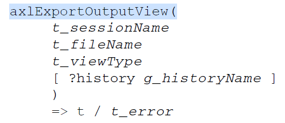

Hi all.
I am using virtuoso IC6.1.8-64b.500.10

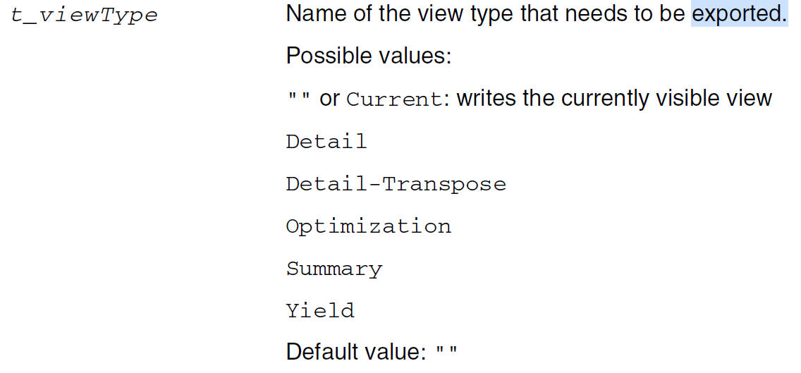

Is there a way to export checks/asserts table, for instance in some structure or csv file:
does not mention this kind of export.
Best regards,
Dragan
    Dragan,
    I did a bit of digging and support for "Checks/Asserts" as the third argument was added in IC6.1.8 ISR7, but the documentation didn't catch up until ISR11 (one after the version you're using). I tested, and it does export when passed "Checks/Asserts" using ISR10 - so it's just the documentation that hadn't caught up.
