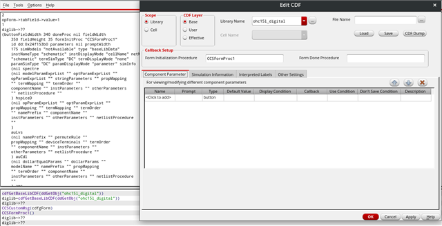

I'm attempting to (roughly) follow the procedure outlined in example 3 in this article:
https://support.cadence.com/apex/ArticleAttachmentPortal?id=a1Od0000000naFVEAY&pageName=ArticleContent
I've added the code at the end of the post to my local .cdsinit file to test the implementation but it is not working as expected. I've verified from the CDF base data structure that the formInitProc value is being set correctly (see the screenshot). The commented printf("hello") statement was added at one point to see if the function is being called at all and it appears that it is not as this never shows up in the CIW. I have also opened a schematic and instantiated a cell from the library I'm trying to restrict the usage of and then checked the result of the if statement that controls the schematic checking portion of the code and it evaluates to 't'. I have also verified that the .cdsinit file is being loaded correctly as I can call the second function in my code: CCSCustomMsg from the CIW successfully. I don't understand how the form initialization procedure knows to pass a single correct argument to the CCSFormProc1 function, there isn't anything mentioned about this in the linked article so maybe that's the problem.

    Hi Kevin,
    I tried your code, and it worked for me - but to be honest it seems to completely mess up the create instance form in schematic. I have to mess around changing the library, cancelling the form and trying a few more things to get it to work.
    I'll contact the author of the article to see if they can investigate further.
    Andrew Beckett over 4 years ago in reply to Andrew Beckett
    Actually, it seems a bit better if I changed the dialog form to have the argument as form rather than cdfgForm, and also changed to be called before it blanked out the library name and cell name fields:
