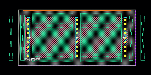

I'm creating a layout pcell in which i instantiate a few transistors, amongst other things. Of those transistors, I'd like to (I mean: I have to) add pins to the pcell which are at the exact location of the gate of those transistors. Is a build-in SKILL procedure available that simply takes the terminal information from an instance and creates copies of it in the current level? Or do I have to build those pins myself, using dbCreateNet/dbCreatePin/dbCreateRect/dbCreateLabel/...?
To illustrate it a bit more. Imagine creating a pcell which instantiates just one transistor. The pcell must have pins, and all pins should be identical to the pins in the transistor it instantiates. So the pcell should have a source pin on top of the source pin of the transistor, the same for gate/drain/back-gate. This means same layer, same name, same geometry, everythign the same, just "one level up". It is easy to get the information from the pins in the instantiated transistor. However, I couldn't find an easy solution for copying/creating those pins at the pcell level.
Thanks in advance.

    Hi Sjoerd,
    There's not really a simple built-in function to do this - you'd have to do it yourself, unfortunately. That said (and I'm sure you know I'm going to say this), this is staggeringly easy to do with PCell Designer:
    The "copy terminals" command does exactly this. The PCell above is instantiating a transistor and then propagating the terminals upwards.
    Of course, I'd be happy to talk to you about potentially using PCell Designer ;-)

    Hi Andrew,
    That was the expected answer. I'd love to use the PCell Designer, however, for some reason my CAD department decided not to allow this tool to be used (in a DM I can give you the reason though). I'm compiling a list of things why I should be allowed to use this tool, and this has already made it to this list. So for now, I'll go ahead and write my own procedure to copy terminals...
    Thanks for your time.

    If you haven't already written it I did this recently:
    oldLayView = dbOpenCellViewByType(oldLibName cellName "layout" "" "r")
    ;Iterate over the shapes of the old layout to copy the pins and pin labels to the new layout, also rename the power/ground pins
    foreach(shape oldLayView~>shapes
    ;Find and copy all MET1 pin objects
    if(shape~>lpp == list("MET1" "pin") then
    newLayFig = dbCopyFig(shape newLayView)
    ;Re-name the supply labels
    if(newLayFig~>objType == "label" then
    if(newLayFig~>theLabel == "vdd!" then
    newLayFig~>theLabel = "vdd018"
    if(newLayFig~>theLabel == "gnd!" then
    newLayFig~>theLabel = "vss018"
    ;For the shapes create terminals and pins with the updated names
    ;for power/ground and make a copy of the input and output pins
    else
    case(shape~>pin~>net~>name
    ("vdd!"
    layNetVDD = dbCreateNet(newLayView "vdd018")
    dbCreateTerm(layNetVDD "vdd018" "input")
    newLayFig~>pin~>net~>name = "vdd018"
    layPinVDD = dbCreatePin(layNetVDD newLayFig)
    ("gnd!"
    layNetVSS = dbCreateNet(newLayView "vss018")
    newLayFig~>pin~>net~>name = "vss018"
    dbCreateTerm(layNetVSS "vss018" "input")
    layPinVSS = dbCreatePin(layNetVSS newLayFig)
    (t
    layNetIO = dbCreateNet(newLayView shape~>pin~>net~>name)
    dbCreateTerm(layNetIO shape~>pin~>net~>name shape~>pin~>term~>direction)
    layPinIO = dbCreatePin(layNetIO newLayFig)
    I was doing something rather specific here so you'd need to modify it to suit you but this should work for you. You can change the if statement to a case statement assuming you have more than one layer that has desired pins on it.

    I already started coding, and my case is a bit different. The main transistor instantiated by my pcell has two gate pins on each gate; the transistor may have more then one finger. See the image below for a two-finger example.
    In the example, you'll see two gate fingers (filled green, wide rectangles in "portrait") and each finger has 2 pins: 1 at the top (above the diffusion area, pink-ish in color, dashed) and 1 at the bottom (below the diffusion). When I do the following (after setting variable "o" to the id of this instance) (searching for gate terminals):
    terminals = setof( terminal o~>master~>terminals pcreMatchp( "^G" terminal~>name ) )
    The variable "terminals get this value:
    (db:0x5f03cb9b db:0x5f03cb9c)
    As you can see, two terminals for the gate.

    This is what I have to replicate. In my code, I (try to) do it like this:
            terminalList = setof( terminal instId~>master~>terminals pcreMatchp( "^G" terminal~>name ) )
            foreach( terminal terminalList
                netId = dbCreateNet( cvId terminal~>net~>name )
                termId = dbCreateTerm( netId terminal~>net~>name "inputOutput" )
                foreach( pin terminal~>pins
                    instTermPinFig = car( pin~>figs )
                    pinFigId = dbCreateRect( cvId instTermPinFig~>lpp instTermPinFig~>bBox )
                    pinPinId = dbCreatePin( netId pinFigId pin~>name)
                    pinLabelId = dbCreateTextDisplay( pinFigId->net
                                    pinFigId
                                    list( car( instTermPinFig~>lpp ) "pin" )
                                    t
                                    centerBox( pinFigId~>bBox )
                                    "centerCenter"
                                    "R0"
                                    "roman"
                                    0.1
                                    nil nil t nil t
                                    "name" )
                ) ;;; end of foreach pin
             ) ;;; end of foreach terminal
    This may not be the most efficient way of doing it, but so far LayoutXL accepts this. Still, have to do some more testing LVS for instance) but so far so good.
    I still have to find a solution for the mustJoinTerms parameter. This is not working:
             when( mustJoinTermsList
                 foreach( terminal mustJoinTermsList
                     terminal~>mustJoinTerms = remove( terminal mustJoinTermsList )
                 ) ;;; end of foreach mustJoinTerms
             ) ;;; end of when
    The error it generates:
    *Error* setSGq: (DB-370034): dbSetq: Cannot set attribute - mustJoinTerms
    No clue how to do this yet.
                                    pinFigId
                                    t
                                    "centerCenter"
                                    "R0"
                                    "roman"
                                    0.1
                                    nil nil t nil t
                                    "name" )
             ) ;;; end of when
