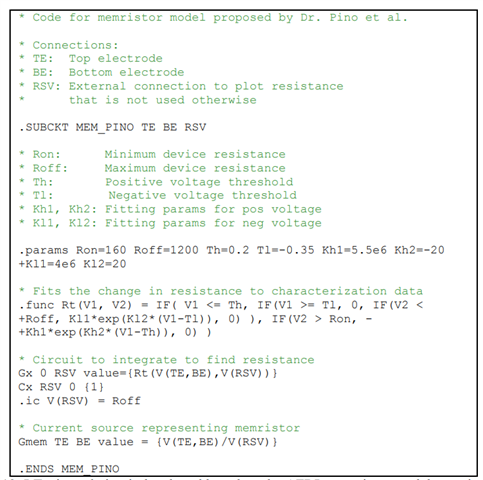

Hello All,
I have done simulation for my project with spice code of Memristor in cadence virtuoso and now I want to do layout for the same. But, as it is not defined for the layout of memristor. Could anyone suggest me on how can i do?
Memristor model used in virtuoso as spice is shown below:
Source: PHD Dissertation, Yakopcic.
