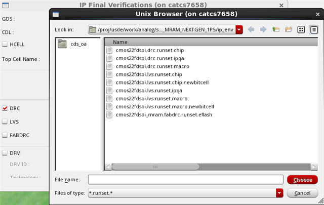

I am having an issue on my code which uses a ddsFileBrowseCB function but it is getting the cache file name and not the actual file name.
hiCreateFormButton(
?name 'drcBrowse
?buttonText "Browse"
?enabled nil
?callback "ddsFileBrowseCB(hiGetCurrentForm() 'drcRunset \"*.runset.*\" 'existingFile)"

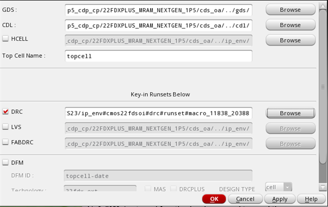

I can see and browse the files properly but after I select it, it is showing the cache file name where the runsets are softlinked to.
Is there any option to get the real actual file name (.runset) if the file is linked to a cache server?
