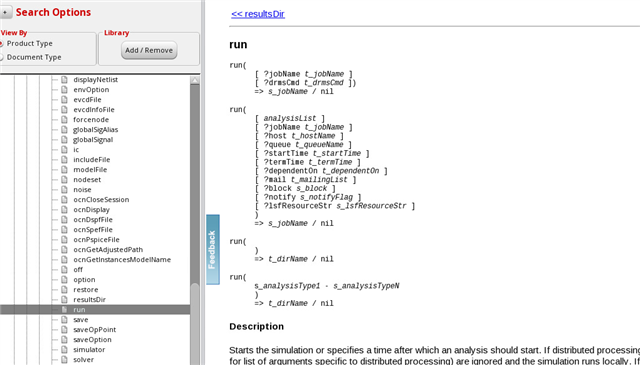

My test bench has a reading model error now but below script return the "path". I expecte getting "nil" as the returned value.
How to check the simulation's fail ?
F_sim_pass=run()

    I don't see this function run() in the documentation but are you sure it doesn't just return t after it has executed?

    The run() is including Ocean reference.
    And I could run a simulation by this command.
    Andrew Beckett over 4 years ago in reply to ichiro
    The run() function does not return the success/failure of simulation - as is clear from the documentation.
    Usually I'd do this by seeing whether the expected result database is present - for example looking at the return value of results() and seeing whether the analysis I'm expecting is present (using member() for example).
