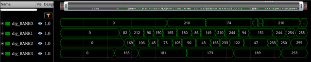

Convert a bunch of analog waveform into integer value
delgsy
delgsy over 4 years ago
I found the solution from this post.
It works only the first time I do it.
Then, I RMB and send it to calculator and put it into the output.
But it does not work.
Sending it to "ADE" or "calculator as list" does not work as well.
I appreciate any suggestion to try.
  • delgsy
    This is the original expression from the first time sending it to calculator.
    awvCreateBus("BANK3" list(awvAnalog2Digital(leafValue(VT("/BANK3<7:0>") "bit" "/BANK3<7>" "Design_Point" 1.0) nil nil 0.6 nil "centre") awvAnalog2Digital(leafValue(VT("/BANK3<7:0>") "bit" "/BANK3<6>" "Design_Point" 1.0) nil nil 0.6 nil "centre") awvAnalog2Digital(leafValue(VT("/BANK3<7:0>") "bit" "/BANK3<5>" "Design_Point" 1.0) nil nil 0.6 nil "centre") awvAnalog2Digital(leafValue(VT("/BANK3<7:0>") "bit" "/BANK3<4>" "Design_Point" 1.0) nil nil 0.6 nil "centre") awvAnalog2Digital(leafValue(VT("/BANK3<7:0>") "bit" "/BANK3<3>" "Design_Point" 1.0) nil nil 0.6 nil "centre") awvAnalog2Digital(leafValue(VT("/BANK3<7:0>") "bit" "/BANK3<2>" "Design_Point" 1.0) nil nil 0.6 nil "centre") awvAnalog2Digital(leafValue(VT("/BANK3<7:0>") "bit" "/BANK3<1>" "Design_Point" 1.0) nil nil 0.6 nil "centre") awvAnalog2Digital(leafValue(VT("/BANK3<7:0>") "bit" "/BANK3<0>" "Design_Point" 1.0) nil nil 0.6 nil "centre")) "Unsigned Decimal")
    It works if I delete " "Design_Point" 1.0 ".
    awvCreateBus("BANK3" list(awvAnalog2Digital(leafValue(VT("/BANK3<7:0>") "bit" "/BANK3<7>") nil nil 0.6 nil "centre") awvAnalog2Digital(leafValue(VT("/BANK3<7:0>") "bit" "/BANK3<6>") nil nil 0.6 nil "centre") awvAnalog2Digital(leafValue(VT("/BANK3<7:0>") "bit" "/BANK3<5>") nil nil 0.6 nil "centre") awvAnalog2Digital(leafValue(VT("/BANK3<7:0>") "bit" "/BANK3<4>") nil nil 0.6 nil "centre") awvAnalog2Digital(leafValue(VT("/BANK3<7:0>") "bit" "/BANK3<3>") nil nil 0.6 nil "centre") awvAnalog2Digital(leafValue(VT("/BANK3<7:0>") "bit" "/BANK3<2>") nil nil 0.6 nil "centre") awvAnalog2Digital(leafValue(VT("/BANK3<7:0>") "bit" "/BANK3<1>") nil nil 0.6 nil "centre") awvAnalog2Digital(leafValue(VT("/BANK3<7:0>") "bit" "/BANK3<0>") nil nil 0.6 nil "centre")) "Unsigned Decimal")
