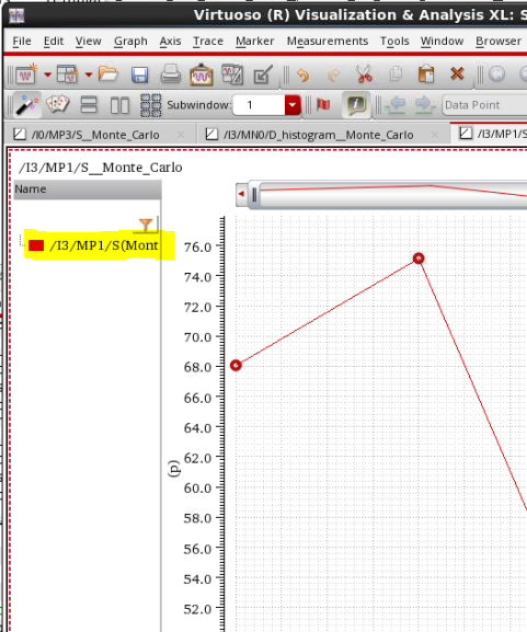

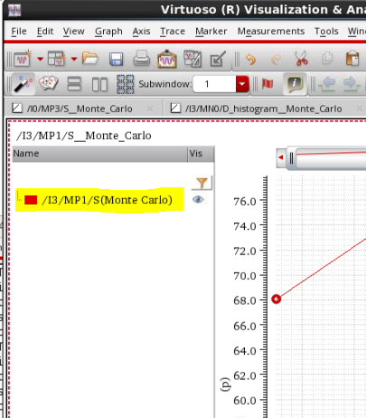

Hi all.
I am using Virtuoso IC6.1.8-64b.500.17
Is there a way to do stretching signal names in ViVA from SKILL code?
For example this initial layout:
should look like this:
Best regards,
Dragan
    Dragan,
    awvSetLegendWidth() is the function you want.
  • dragank
    dragank over 4 years ago in reply to Andrew Beckett
    awvSetLegendWidth("auto")
    seems like a default value.
    It does not do stretch to fit labels.
    I have to do setting value in argument to awvSetLegendWidth
    Is there any way to set ViVA to open windows in full screen?
    Andrew Beckett over 4 years ago in reply to dragank
    Not full screen, but you can do this:
    envSetVal("viva.graphFrame" "width" 'string "2000")
    envSetVal("viva.graphFrame" "height" 'string "1200")
    or whatever is a suitable size.
