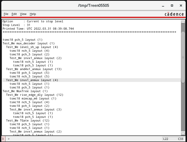

  • Marben
    Marben over 4 years ago in reply to Andrew Beckett
    Hi Andrew,
    I want to extract the cellnames from the output of Shift - T command or Edit - Hierarchy = Tree,
    and save it to a file.
    The cellnames are displayed in the second column of  of the Tree output as shown above.
    How to do that in SKILL?
    Best regards,
    Marben
    Andrew Beckett over 4 years ago in reply to Marben
    Hi Marben,
    There's no SKILL support for that - but the code in my article How to print a hierarchy tree of a config-based schematic, normal schematic, or layout view could be used instead.
