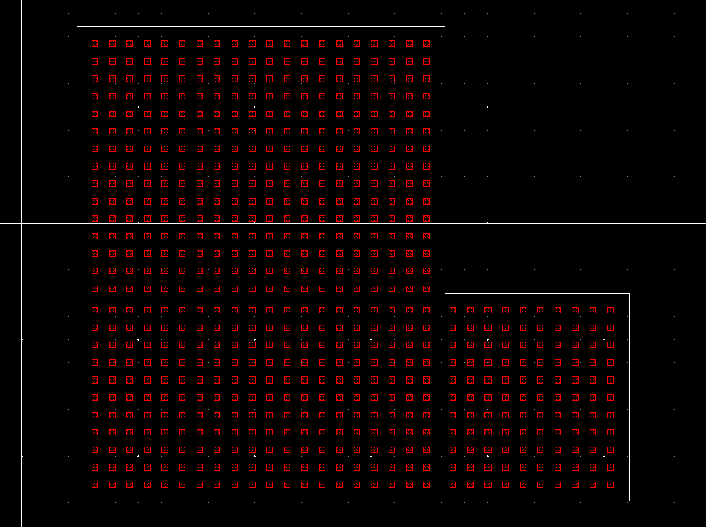

    Sjoerd,
    This works for me. I don't need to create the temporary polygon either - I just pass the INDDMYShape to the rod function (it behaves the same if I do this or use the tempId). Also, if I use the ?outputFillShape I get the list of created shapes:
    The only time it fails is if the area is too small (it still returns t normally), or there's also the fact that if the rectangles are too small compared with the area you might not see them unless you increase the resolution on the Options->Display form (although I'm guessing that's not your problem).
    I can't see any reason why this would fail otherwise.
