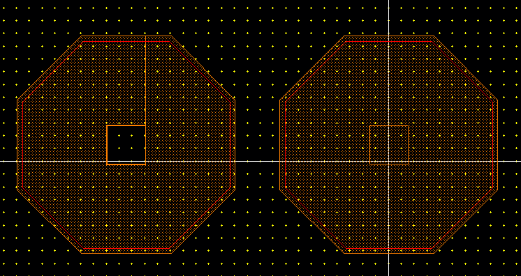

    I'm currently drawing an octagonal pad using the rodCreatePolygon() function. The resulting polygon drawn is shown on the right below. In SKILL, after drawing the polygon, I'd like to chop off a rectangular section defined on another layer as shown on the left below. I've been thinking of different ways of doing it but I'm curious if you have any recommendations on how to go about this. The pad is a pCell, so I know that I can't use any functions from the "le" family. The code is also included below with what I'd like to do commented.
Nishant.

    Andrew Beckett over 4 years ago in reply to Ynishant +1
    Yes, you could also use the advanced boolean engine APIs too. This is limited to 45-degree polygons but does support shapes through the hierarchy. It also involves a few steps to convert to and from abe…
    Something like this at the end of your code:
    		opening = rodCreatePolygon(
    			?layer OPENING
    			?pts   list( p1 p2 p3 p4 p5 p6 p7 p8)
    		dbLayerAndNot(pcCellView OPENING list(opening~>dbId) list(poly2~>dbId))
    		dbLayerAndNot(pcCellView MTOP list(poly1~>dbId) list(poly2~>dbId))
    		dbDeleteObject(opening~>dbId)
    		dbDeleteObject(poly1~>dbId)
    (I added opening as a variable in the let too)
    I may have misinterpreted your precise requirements, but this should give you a clue at least.

    Thank you Andrew, this is exactly what I'm looking for! Just two follow up questions:
    1. I noticed that the advanced Boolean engine(ABE) also has an abeLayerAndNot() function. I assume using that would also accomplish what I want?
    2. Does chopping the above ROD Object cause it to lose its ROD attributes?
    1. Yes, you could also use the advanced boolean engine APIs too. This is limited to 45-degree polygons but does support shapes through the hierarchy. It also involves a few steps to convert to and from abe layers - probably no benefit in this example.
    2. You're not actually chopping the ROD object, but creating a new database object from the original (I was deleting the original objects). You could use rodNameShape to create a rod object from the new shapes created by dbLayerAndNot (note that dbLayerAndNot returns a list of objects it created, as it could end up with more than one object).
