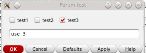

for above code it creates three check boxes 1 ,2 ,3 ...i want that when if check box 2,3 are checked or if all three are checked then it should not prompt any error...and if only box 3 is checked then it should throw error message to check box 2 and 3 together?
how to achieve that

    Lemme clear you more. If i run above code- i get this forum, now
    in this i want ,when am selecting only test3 , it should throw error via dialog box that test3 cannot select alone, test2 and test3 both should be selected.
    How can we do that as u say Presumably you'd put it in the form callback (it would get a bit annoying if it was on the toggle field callback)
    drake
    Andrew Beckett over 4 years ago in reply to Drake96
    toggle_Entry=hiCreateToggleField(
      ?name 'toggle_Entry
      ?choices list(list('aa "test1") list('bb "test2") list('cc "test3"))
      ?value list(nil nil nil)
      ?callback list("CCFupdatePathEnter(hiGetCurrentForm())")
    procedure(CCFupdatePathEnter(form)
      let((listOfStrings)
        listOfStrings=
          setof(elem
            foreach(mapcar (toggle data) form->toggle_Entry->value
              list("1" "2" "3") toggle && data)
            elem
        if(listOfStrings then
          form->path_enter->value=strcat("use " buildString(listOfStrings ","))
        else
          form->path_enter->value=""
    procedure(CCFvalidateToggleFields(form)
      if(form->toggle_Entry->value=='(nil nil t) then
        hiDisplayAppDBox(
          ?name 'CCFbadToggles
          ?dboxBanner "Please take SKILL course"
          ?dboxText "Cannot select only test3"
          ?dialogType hicErrorDialog
          ?dialogStyle 'modal
        hiSetCallbackStatus(form nil)
      else
        hiSetCallbackStatus(form t)
    path_enter=hiCreateStringField(
      ?name 'path_enter
    ; commented out so can see what is going on
    ;  ?invisible t
    hiCreateLayoutForm(
      'ForumForm
      "Forum test"
      hiCreateFormLayout(
        'lay
        ?items list(toggle_Entry path_enter)
      ?callback 'CCFvalidateToggleFields
      ; allows the form callback to veto the unmapping of the form
      ?unmapAfterCB t
    hiDisplayForm(ForumForm)
