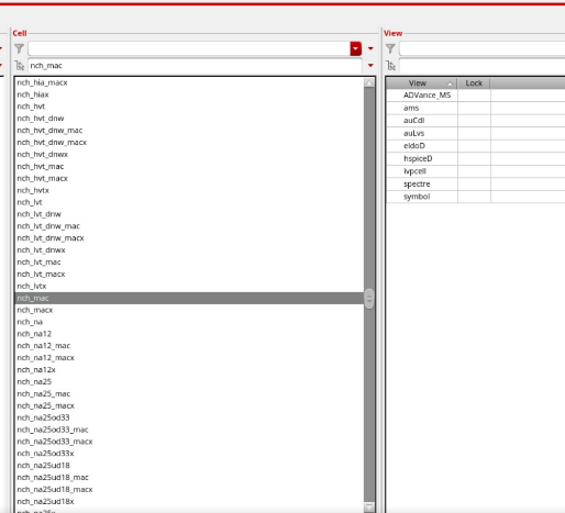

Hi all,
Thanks for your reply in advance.
We have encountered an issue about the layout disappeared issue while converting CDB to OA.
Everything in our PDK kit is converted successfully, except for nch_mac.
Unfortunately, nch_mac is an extremely essential device.
Please anyone?

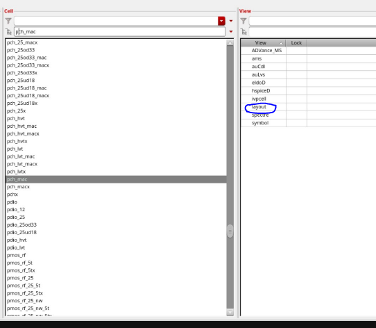

left is pch_mac; right is nch_mac
Sincerely

    Danielrayray over 4 years ago in reply to Andrew Beckett
    Hi Andrew,
    Thanks for the reply!
    The problem is due to the path definition of IC5.14.1 and IC6.
    We must revise the physical path of your library in IC5.14.1 into the relative path and then convert it by cdb2oa.csh.
    The following is the command line written in the cdb2oa.csh :
    Rcdb2oa -cdslibpath ../icfb/cds.lib -lib YOUR_LIB -log cdb2oa.log
    Before converting, we should make a directory, eg. Virtuoso, then copy display.drf from IC5 and then source cdb2oa.csh.
    After converting, copy cds.lib from foundry PDK into your directory.
    In the end, inclide YOUR_LIB into the cds.lib
