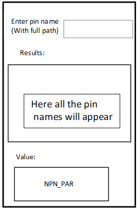

How can i create a Window like this
Below results i want to have report field but somehow  i am not able to place report field and string field in same form, whenever i try to place report field and string field in same form only the report field is being executed.
Thank you in advance if anyone can help me with the code. Rest callback functions i will design myself.

    Are you using layout forms? They are based on Qt and make it very simple to achieve this kind of result
    Are you using different field names? If not make sure all your fields have a unique name so they can be referenced afterwards. If two fields have the same name only one will appear on the GUI, this might be the source of your problem
    (I don't think this is documented but you should definitely avoid some field names: 'name or 'type at least !
    Otherwise you will encounter tricky errors...
    I advise you to use prefixed names using underscores, this way you are sure to never raise this kind of error)
    Here is a code snippet doing something like what you ask:
    (hiDisplayForm
      (hiCreateLayoutForm 'my_custom_form "Custom Form"
        (hiCreateFormLayout 'main_layout ?items (list
            (hiCreateStringField ?name 'pin_name ?prompt "Pin Name\n(Full Path)")
            (hiCreateReportField ?name 'pin_results ?title "Results")
            (hiCreateMLTextField ?name 'pin_value ?prompt "Value")
            ));main_layout
        ));display_form
    Hope this helps
    Cheers,
    Aurélien

    Andrew Beckett over 4 years ago in reply to Purbayan
    Why are you putting list(ListNetPins t) in the field list? That's completely invalid and I've no idea why you think that would work.
    If you just use the field directly:
    ?fields list(InternalNetname TargetPinname Go sep1 ListNetPins ResultField)
    it tells you:
    *Error* hiCreateAppForm: form TrFileForm, field ListNetPins: report field invalid in 1D forms
    So you either need to specify each field as a list with coordinate information (see the 2D form documentation), or use a layout form as Aurélien suggested (which is far easier). I don't really see why what he suggested is "not what you want". It sounds exactly like what you want!
