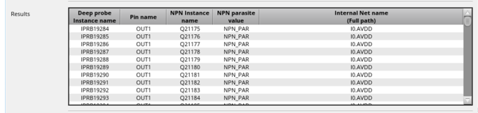

As you can see i have my report field, i want to update my report field with new value of NPN parasite(basically instead of NPN_PAR it would show new value in a specific row) after someone edits the value of NPN parasite. My question is how can i update report field only.
What i am doing as of now is i created a list called TABLE_LIST_FORM_RESULTS which have all the data like this
(("IPRB24955" "OUT1" "Q26846" "NPN_PAR" "I0.LDO_LV_dig")
("IPRB24956" "OUT1" "Q26847" "NPN_PAR" "I0.LDO_LV_dig"))
and i pass this TABLE_LIST_FORM_RESULTS variable to ?choices keyword to display my data in report field
after editing the value for example of Q26847 to pipo and then again  i check the list by calling variable TABLE_LIST_FORM_RESULTS i see the list is updated
("IPRB24956" "OUT1" "Q26847" "pipo" "I0.LDO_LV_dig")
but but my report field still remain same.
it usually shows this error:
*WARNING* hiDeleteForm: Cannot delete a form that is mapped or from within the form's callback (NPN_parasite_manager)
*WARNING* hiCreateLayoutForm: Could not delete previously created form NPN_parasite_manager
    You wouldn't normally achieve this by recreating the form - because to do that you'd have to cancel the current form and recreate it - otherwise you get exactly the error you are getting - it needs to be able to delete the form before recreating it, and you can't delete a form that is currently mapped (i.e. displayed on the screen).
