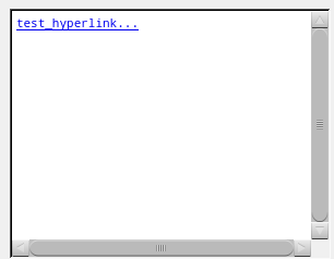

    Andrew Beckett over 4 years ago in reply to Drake96
    Given that hiViewFile has no arguments, you can't control the position/size of anything using that function.
    You could create a hypertext field, for example:
    hyper=hiCreateHypertextField(
      ?name 'hypertext
      ?value "<A href=/home/myuser/.cshrc>Link</A>"
  • Drake96
    Drake96 over 4 years ago in reply to Andrew Beckett
    Gotcha,
    Andrew is there way to remove the background menu ..only link should be there..i check the doc but couldn't find any options?
    What "background menu"? I have no idea what you're talking about.
  • Drake96
    "background menu" is there a way to only have link not that "box"?

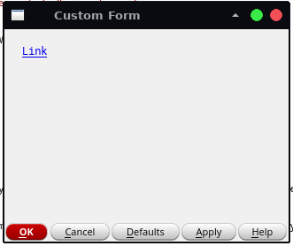

  • AurelBuche
    AurelBuche over 4 years ago in reply to Drake96
    ?name 'hypertext
    ?shadowed nil
    ?hasVerticalScrollbar nil
    ?hasHorizontalScrollbar nil
    ?value "<body style='background-color:#F0F0F0; font-family:Roboto Mono; font-size:12px;'>
    <A href=/home/myuser/.cshrc>Link</A></body>"
    (hiDisplayForm
    (hiCreateLayoutForm 'custom_form "Custom Form"
    (hiCreateFormLayout 'main_layout ?items (list hyper))))
  • AurelBuche
    ?name 'hypertext
    ?shadowed nil
    (hiDisplayForm
