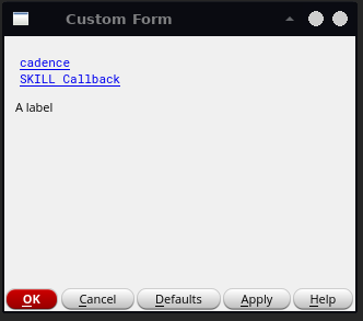

    AurelBuche over 4 years ago in reply to Drake96 +1
    I already sent you a solution for that... I guess you weren't satisfied with the size of the field but you never answered and just opened another thread... Here is another updated version showing how…

  • AurelBuche
    Here is another updated version showing how you can play with stretch items (you could also add spacer items to achieve exactly what you want)
    (hiDisplayForm
      (hiCreateLayoutForm 'custom_form "Custom Form"
        (hiCreateVerticalBoxLayout 'main_layout ?items (list
            (list (hiCreateHypertextField ?name 'cadence_link_field
              ?value "<body style='background-color:#F0F0F0'>
    <a href='www.cadence.com'>cadence</a><br>
    <a href='skill:(println 12)'>SKILL Callback</a>
    </body>"
              ?shadowed nil
              ?hasVerticalScrollbar nil
              ?hasHorizontalScrollbar nil
              ) 'stretch 1)
            (hiCreateLabel ?name 'custom_label ?labelText "A label")
            '(stretch_item 10)

  • AurelBuche
    Another example with a spacer item, maybe closer to what you want:
    (hiDisplayForm
    </body>"
              ?shadowed nil
              ) 'stretch 1)
            '(spacer_item -15)
            '(stretch_item 10)

    Andrew Beckett over 4 years ago in reply to Drake96
    Drake96 said:
    Is it feasible?
    Yes, you need to look at the example above using the skill: protocol and to read the documentation. As you can see, that's using skill:println(12) - of course it could use 'skill:view(\"someFile\")' as the href.
    You are getting close to getting blocked because you keep asking similar questions or don't do ever basic research and experiment or tries from the documentation, and are consuming a lot of the valuable time of multiple contributors here. Please think carefully when asking questions.
