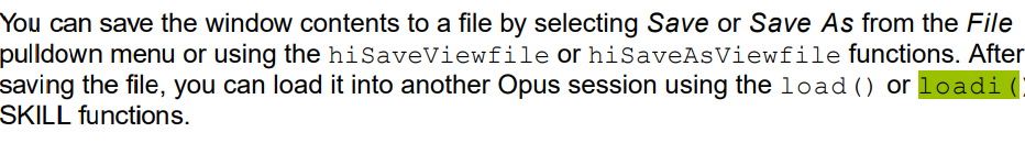

Hi everyone.
I use an skill that loads all the skills I commonly use. Is there a way of ignore errors when loading and continue with the other skills?
My reason for trying this, is because every time I upload my code, I need to wait like 5-6 minutes to see it on the server.
and I would like to be able to load everything else, modify that code, keep working and after a while load only that script already fixed.
Regards
R. Gómez

    I don't really understand why you would need to wait 5-6 minutes to see an updated file - something sounds seriously wrong with your file system if that's the case.
    It sounds as if loadi() is what you want rather than load().

    Hi Andrew,
    Thanks for your response.
    Yes, there is something wrong with my file system, I have already make tickets about it, but I think It will take a while to solve. Either way, I found errset in one on your reply's, and that will help me solve that.
    About loadi() could you describe what does the fn do?, or what is the difference with load(). I haven't found any information about that function in the manuals, just "uses" as in the attached image.
    Regards.
    R. Gómez

    From a simple search of the product manuals on support.cadence.com : Cadence SKILL Language Reference -- Input Output Functions - loadi
  • RicardoGV1
    RicardoGV1 over 4 years ago in reply to Andrew Beckett
    I'm so sorry Andrew, I didn't have that pdf. Thanks a lot.
