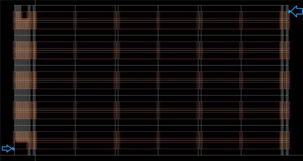

Hello everyone,
This is my first post on the Cadence Forum. I've been learning SKILL for one year and half now and I've always found solutions to my problems by creating new SKILL procedures or finding online support/documentation.
I look for a solution on the forum but did not find anything suitable so here I come to ask your guidance.
My problem is the following :
I have a layout cellview containing several instances, several matrix instances (same instance within a matrix repeated in rows and columns) whose instancing other cells below in the hierarchy.
I want to retrieve the extremes coordinates of a chosen Layer Purpose Pair from the TOP layout cellview coordinates origin.
I tried many things with the procedure dbShapeQuery and I manage to create a procedure that works to a certain extent. I have a matrix instance in my TOP layout that has 2 columns and a distance X delta between the columns, for some reason I cannot retrive the far right coordinate of my target lpp (list("NW" "drawing")).
Please find the code that I tried below :
;PURPOSE : Find the extremes right, bottom, left, top coordinates of a layer purpose pair (lpp) within a cellView

findExtremesCoordinatesOfLayerFromCv(getEditRep(), list("NW" "drawing"), t)
The purpose is to get the 4 extremes coordinates extracted from the two blue points showed in the screenshot below. Exactly like how the bBox is computed automatically for a layout cellView and retrieved by : cvLayout~>bBox but to shrink/filter it to only a chosen Layer Purpose Pair.
If you have questions, I will detail more and share more screenshots.
Thank you in advance for taking time to read my message, any suggestions is welcomed, I hope we can solve this problem together.
Cordially, Steven.

    StevenR over 2 years ago
    Hello everyone, after fighting hard with the mosaic hierarchy, I managed to get the extreme coordinates in any rotation value of instances, mosaic instancing instances or standard cell directly (first has a level of hierarchy more than if was for the second). Please find my code below.
    I am conscious it is a first version and improvements can be made, please tell me what do you think and if this function can be of use to you.

    Andrew Beckett over 2 years ago in reply to StevenR
    Steven,
    I think this is a bit more complicated than it needs to be, but a good attempt nevertheless! I think it might generate a lot of data by building lists of edges, plus you're appending to the end each time which could get slow for a large set of data. I've not really reviewed the code (sorry, just back from vacation and so don't have too much time). You might want to take a look at the approach for handling mosaics here (sorry, it's in LISP syntax, but hopefully you'll get the idea):
    How to flatten a specific layer and measure the total area of that layer ?
    However, if the data is always orthogonal or 45-degree (quite likely), you could take advantage of the abe functions (Advanced Boolean Engine). This code would do what you want quite efficiently and with little code (it handles the hierarchy automatically). I wrote it in C-style to match what you were doing:

  • StevenR
    StevenR over 2 years ago in reply to Andrew Beckett
    Andrew,
    Thank you for providing a detailed and clear explanation and code. You are right, I tried to work with dbShapeQuery but with a mosaic instancing another custom instance it was just complicated to handle and it made the code messy.
    This is working perfectly fine and the shapes that I'm working with are always orthogonal (can be any rotation but those are always 90°/180°/270°/360°) which will work with what you provided.
    The ABE is really useful and I will try to learn more about it.
    The mosaics were really problematic to handle with dbShapeQuery(), do you think this layout structure is okay to work with or is it better to use another form of "instance matrix" such as the groupeArrays ?
    I saw this and it looks promising and easier to define with flipping every even row for better Standard cells abutment for example.
    Thank you again for your answer.
    Steven.
