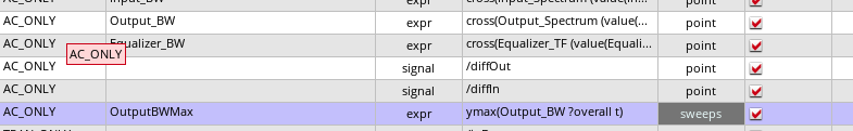

    For each output that you want to find the max over the sweeps, you can add a new output which uses ymax(outputName) and set the evalType column to "sweeps":
    Here you see I've added OutputBWMax to be ymax(Output_BW) - when I set the EvalType to "sweeps" it automatically added the ?overall t to the expression. This then appears in the outputs:

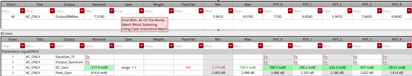

    Notice the extra table at the top with the "measure across sweeps" outputs.
