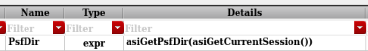

I have an ocean script that I would like run at the end of some of my test runs when running from ade assembler.  I've been doing this by adding it to the tests output setup.  This script requires the knowledge of the test's psf directory to do some post processing.
The method I was trying to use is the following:
session = asiGetCurrentSession()
psfDir = asiGetPsfDir( session )
When I run with just one test selected the script runs without issue.  However, when multiple tests are selected, as one test finishes and runs the script, the directory being returned is for the test that is still running.
Am I doing something incorrectly or is there another methodology I should be using?
Thank you.
  • hunTer
    hunTer over 1 year ago
    I think I've found a work around, by creating an output expression for each test.
    Then calling calcVal( "PsfDir" ) to obtain the value for the output.  However, when calling calcVal, an error is reported in the CIW:
    "*Error* lineread/read: syntax error encountered in input"
    Aise from the error reported in the CIW, it all appears to be functioning okay.  Is this error expected or am I doing something incorrectly?  Any guidance/help is appreciated.
