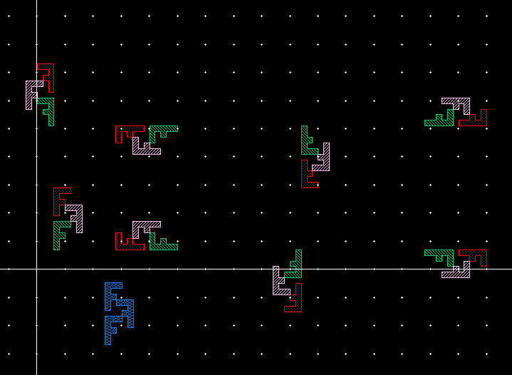

    For example, my figGroup is the blue shapes and the other coloured shapes above are instances of a cell with each of the 8 different orientations.
    I then have figGroup assigned to the blue shapes (which are in a figGroup, with it's origin at the lower left - the same as the origin of the capacitor cell), and select the 8 instances, and run this code:
    moveToOrigin=list(-xCoord(figGroup~>origin):-yCoord(figGroup~>origin) "R0")
    foreach(cap geGetSelSet()
        dbCopyFig(figgroup cv dbConcatTransform(moveToOrigin cap~>transform))

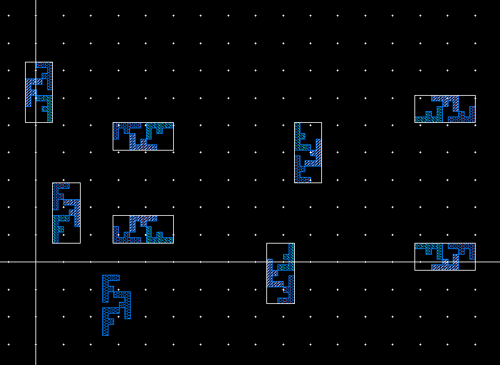

    then it ends up like this:
    As you can see, the copies have the correct orientations.
  • CG20240827312
    CG20240827312 over 1 year ago in reply to Andrew Beckett
    Woah, that works like magic, it is now setting to the required orientation, which was causing the issue, thanks a loads
