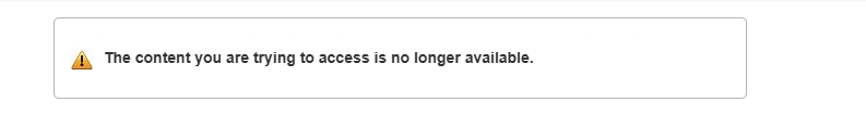

    but thi website I can not open. I don not know Why? view this warning
