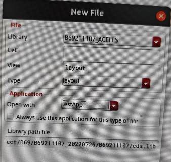

deRegApp doesn't register
New File form display application

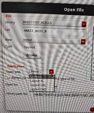

but Open File doesn't display application

    in open file form,add a custom application
    deRegApp(?appName "testApp"
    ?enableTrigger 'etrig
    ?dataTrigger 'dtrig
    ?viewType "testLayout"
    ?parentType "maskLayout")
    in open file form,no new ap p,in new file,new app exist
    Andrew Beckett over 1 year ago in reply to XY202503208123
    Support for applications having a more flexible "Open With" was enhanced in IC23.1 - before that, the apps had to end in L, XL, etc - see https://support.cadence.com/apex/ArticleAttachmentPortal?id=a1Od0000000nZI0EAM&pageName=ArticleContent
    Now you can do:
    deAddAppCapabilities("testLayout" ?openFile t)
    Not clear what you're actually trying to do here, but maybe that's the missing piece. You're presumably not using IC23.1 though since "Layout EAD" is shown and it would be "Layout EXL" in IC23.1
