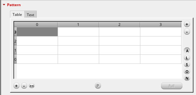

Hi All,
I’m looking for a SKILL command to create an editable table field. I tried using hiCreateReportField(), but it doesn’t provide the functionality I need—specifically, there’s no option to add row headers. Interestingly, Cadence’s "array-assistant" does offer a table with both row and column headers.
I’ve attached an image of the field window I’m aiming to replicate using SKILL.
If anyone has a solution or workaround for creating such an editable table (with row and column headers) using SKILL functions, please let me know.

    Andrew Beckett over 1 year ago in reply to Rahul2025
    Rahul2025 said:
    I have seen your solution but it doesn't helps to create table the one i have shared in image
    Also your table doesn't have any row-headers
    could you please help with an example code for the case shown in my image?
    There's no support for row headers. All you can do is add another column with the headers in.
    The widgets you've shown a screenshot are using native Qt widgets, and the hi* interface doesn't provide such a capability - this would need an enhancement.
    You can’t make it editable - that’s why Max’s article gives an alternative approach to allow editing the contents of the table without the cells themselves being editable. There are numerous enhancement requests for editability of the field, but this has not yet been planned. By all means contact support to request this - that will increase the likelihood of this being implemented sooner rather than later.
