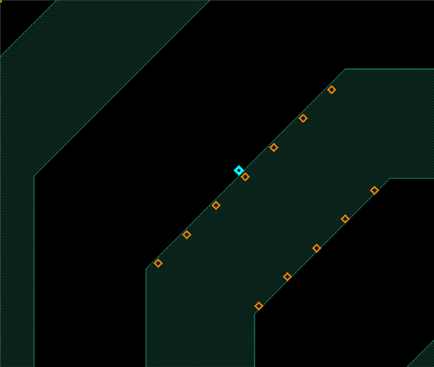

I'm trying to find if a point is inside a polygon as shown in the image below.  Both the functions (geIsPointInsidePolygon & CCSPointInPolygon) fail to test correctly the pink locations in the image for inside. To check if it is due to the polygon, I chopped the lower half to simplify and then the functions test correctly. While I can infer that such complicated polygons are not supported, I could not find what kind of polygons are acceptable.
Can someone here help me to find?

    Ram,
    Could you please select the polygon and then report:
    sstatus(fullPrecision t)
    car(geGetSelSet())~>points
    and then give me some test coordinates that are failing when you call these functions? Then I can check.

    Edited. Thanks for the quick reply. The test points and point list are here,

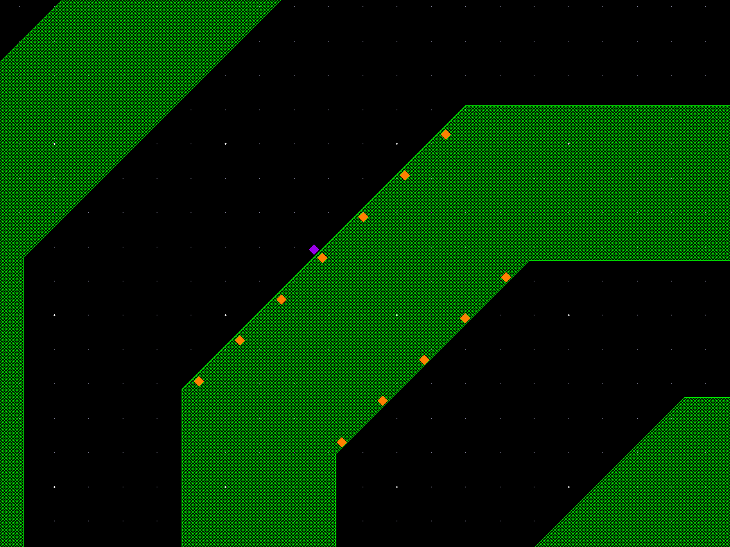

    Andrew Beckett over 1 year ago in reply to RK56
    First of all, what is the DBUPerUU in your technology? You can find this with geGetEditCellView()~>DBUPerUU . Based on the resolution of the coordinates you showed, it's probably 20000 (which is pretty fine resolution - this is unusual - maybe it's finer than that in your case?).
    I then used this code to construct a new shape (adjust the layer names as you see fit) and to create "dot" objects either on Via2 (orange) or Via3 (purple) if inside or outside (respectively) the polygon. I added an extra point outside just to be sure.

    The dots will be shown by using Options→Display and turning on "Dot Pins". Then I get:
    Zoomed in:
    This is all behaving as I'd expect. This gives the same results whether I use CCSpointInPolygon (which I wrote) or geIsPointInsidePolygon.

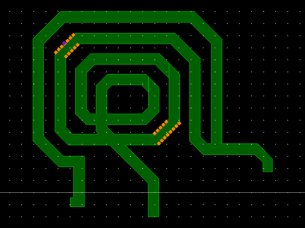

    This returns 4000.0 for my database. It is not 20000 as you guessed. How is the DBUU is related to the problem?
    Your script produces same result as you mentioned. I wonder why
    I will add more details to what I'm doing. You can mention if any of these prior steps cause this. I have these smaller rectangles in layout which are created through script. I test all the four corners of the rectangle of the rectangle for inside of the polygon.
    procedure(testInside(shapeBBox region @optional (check t))
       forall(pt bBoxToPolygonPts(shapeBBox check) CCSpointInPolygon(pt region))

    Are you checking the vertices of those rectangles or the points defined by their bBox?
    This is just a guess, but if you are using the bBox edges, some corners would appear as inside the polygon.

    Apologies - I didn't notice that all your points would work with 4000 as the DBUperUU (i.e. they are all multiples of 0.00025 rather than 0.00005). I was trying to imagine what might make a difference - anyway, it's not this, it seems.
    In that case, I'd need to know how these rectangles are created - how big are they (as your code doesn't show that part)? If they are big enough, maybe one of the points is outside of the polygon...
    In my example I am just checking the points as you gave them, not four additional points derived from the points you specified.

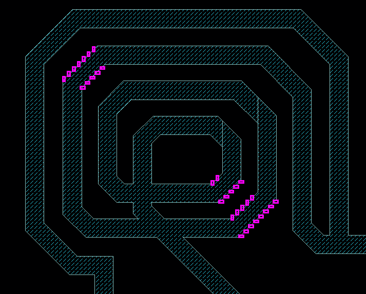

    I have a bBoxToPolygonPts function to take all 4 vertices of the rectangle.

    My bad, I thought the diamonds from the picture were the rectangles and thus their bbox would be bigger than the polygons.
    Then, as Andrew said, if you don't detail the rectangles, it's hard to understand what's going on.
    Andrew Beckett over 1 year ago in reply to Aurel B
    In fact the diamonds were from my pictures (because I was using "dot" objects). Looking again at Ram's original screenshot, you can clearly see that the rectangles straddle the edges and hence it's hardly surprising that a check that is checking that all four vertices are within the polygon will return false. This must be because the rectangles are large enough to straddle the edge.

    Apologies Andrew and Aurel. I had overlooked the "forall" behavior.  Forall returns AND of all test results which I knew, but I used it for a case where any 4 vertices should not overlap the polygon.
    A peer review would have helped. You guys became my peer. Thanks a lot and sorry again.
    PS: Before posting here, I did some coordinate-based test and convinced myself that there is a problem. Now I cannot reproduce.
