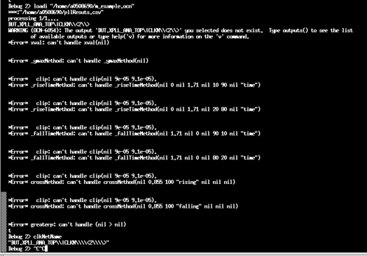

    If you use the net name as it is: DUT.XPLL_ANA_TOP\|CLKN\\<2\\> then you are true that printf() will give you the correct name but when you try to interpret the netName (I named it as clkNetName) in xterm that will show up like this: "DUT.XPLL_ANA_TOP\\|CLKN\\\\<2\\\\>". I want this to show up like: "DUT.XPLL_ANA_TOP\|CLKN\\<2\\>"
    I don't just want to print the clkNetName but want to evaluate certain expressions using that. So, the problem with incorrect interpretation of clkNetName is that xterm gives me warning saying the following:
    WARNING (OCN-6054): The output 'DUT.XPLL_ANA_TOP\|CLKN\\<2\\>' you selected does not exist. Type outputs() to see the list
    of available outputs or type help('v) for more information on the 'v' command.
    Attaching a ss for above warning (I hope it's readable):

    This is nothing to do with whether it's printed or not. Whilst it might show as "\\" the string actually only contains a single "\" and so any usage of it when passed to a function would only see that single "\".
    The problem is almost certainly that the signal is not called what you think it is within the result database. What does outputs() show (that's what the message suggests you use). If outputs() produces a lot of info, try:
    pcreMatchList("^DUT\\.XPLL_ANA_TOP" outputs())
    which will give you any output that begins with DUT.XPLL_ANA_TOP (note, the double backslash here is to provide a single regular expression backslash to escape the dot to prevent it meaning the regex "any character").

    Yes Andrew, that's correct. The signal name in the result database looked different from what I have been entering so far. Now, I am able to do evaluations on the nets.
