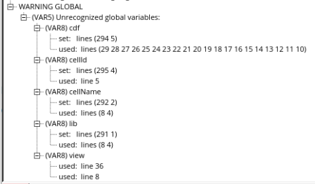

SKILL Lint "Unrecognized global variable" error when referencing CDF default values in pcDefinePCell

Hi!,
I am writing a SKILL PCell and trying to align the default parameter values in the pcDefinePCell by fetching cdfId to ensure the synchronization, as described in the "Introduction to SKILL PCell Programming" RAK (specifically Lab 4: Automatically Aligning Default Parameter Values)".
It describes to define cdf globally and use it in the parameter list and set to nil at the end.

So, When I run SKILL lint on this code, it flages lib, cellName and cdf as unrecognized global variables.
So, I tried wrapping the variables inside the let statement and run the skill lint, the outcome is that it still flags cdf as unrecognized global variable but not the variables lib and cellName.
Why only cdf is still flagged and not the other variables?
I want to know what is the best practice to avoid these warnings? Any suggestions or insights are appreciated.

    First of all, there's a mistake throughout that article (it's an article rather than a RAK, so I couldn't find it initially as I was looking in the wrong place). It uses:
    pcDefinePCell(
      list(ddGetObj(lib) cellName "layout")
      list(
        (w "float" cdf->w->defValue)
        (l "float" cdf->l->defValue)
        (layer "string" cdf->layer->defValue)
      ) ;parameters
      let((cv)
      ;body
      );let
    );pcDefinePCell
    The list should not be present in the formal argument list. It should just be open and close parentheses. SKILL Lint actually reports it as an error (it sees the list as a parameter which is not properly defined). So remove that. I'll request that the article is updated to correct this.
    Newer IC versions correctly handle the use of the cdf variable in a let and don't complain with this code:
    let((cdf lib cellName)
      lib="mylib"
      cellName="testforumpc"
      cdf=cdfGetBaseCellCDF(ddGetObj(lib cellName))
      pcDefinePCell(
          ) ;parameters
        let(((cv pcCellView))
          dbCreateRect(cv layer list(0:0 w:l))
        );let
      );pcDefinePCell
    I tracked down the change, and this was fixed in IC6.1.8-64b.500.30 (aka ISR30).
    In the version you're using, click on the Options icon - top right of the Lint Manager assistant in the IDE - and set cdf in the Global Variables. That will stop it complaining. It's not actually global, but the SKILL Lint rule for pcDefinePCell was not written at that stage to correctly handle expressions in the value part of a parameter definition.
