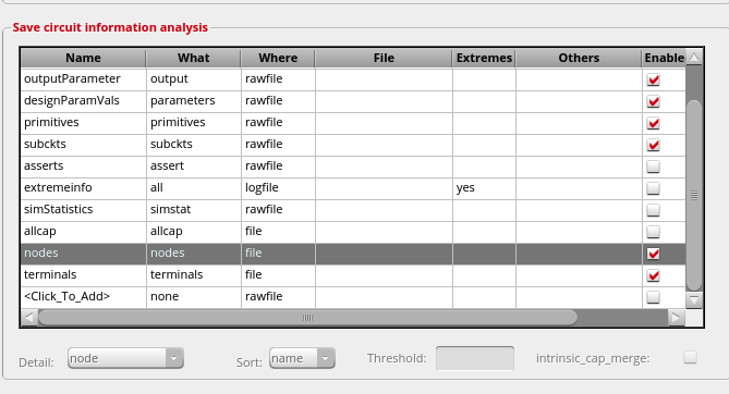

    Andrew Beckett 8 months ago
    Marcel,
    You can get spectre to write out the mapping. It is not something you can get in a binary database, but if you add this entry on the Outputs->Save All form:
    which corresponds to:
    nodes info what=nodes where=file
    (you can specify the file of course; note that rawfile is not supported for this), then you get:

    That would be fairly easy to parse. The terminals info result contains the same info but the other way around - for each net it tells you the instances/terminals which are connected.
    The other way would be to take the instance name you've found, convert to a schematic name, traverse the hierarchy (potentially complicated if there's a config involved) find the instance and then find the instTerms and construct the hierarchical net names which are attached. That's a lot more work!
