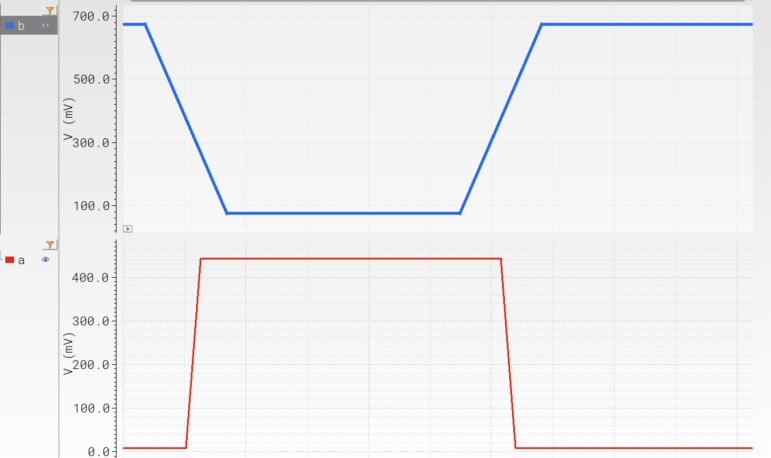

I am using viva to review waveforms, usually with multiple strips
During examination of waveforms, I wish to place a horizontal (Y) marker on selected waveform's strip, at a certain position (example below)
I have used the skill function: awvPlaceYMarker, and used its argument: ?stripNum
This is the skill function i've assembled (the y value is 0.3)
awvPlaceYMarker(awvGetCurrentWindow() 0.3 ?stripNum awvGetStripNumberOfSelectedTrace(awvGetCurrentWindow()) ?label "test")
This skill function does not work reliably - it places Y marker at wrong strips, or in other cases does not place any marker
Please guide me - how to correctly assemble a reliable skill function that places horizontal Y marker on selected waveform strip
Thanks
Daniel

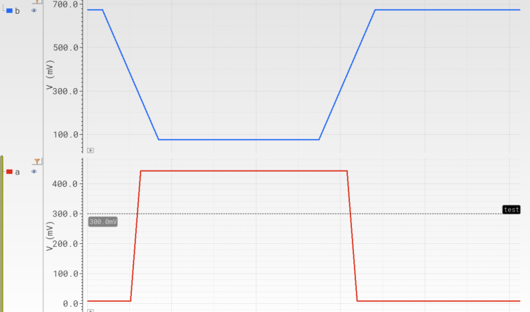

The example: there are two waveforms, each is placed in its separated strip, see image below, signal names: a (red, bottom strip), b (blue, top strip)
I selected the signal 'b' (top strip), activated the skill function, and the Y marker was placed on signal 'a' strip (bottom strip)
    Andrew Beckett 8 months ago
    On my first attempt, this worked fine. Then I moved strips around, and awvGetStripNumbersList(awvGetCurrentWindow()) was returning (2 3). I attempted to place a y marker on strip 3, and it failed - I had to use strip 1 for it to work, which is odd.
    Please contact customer support (use the Case menu after logging in to submit a support case) about this to report the bug.
