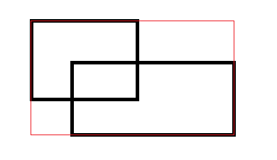

  3. Hi Is there any way to compute BBox of 2 BBoxes?
  • Subscribers 151
  • Views 1022
Ganesh B
Ganesh B 7 months ago
  • p94todorov
    p94todorov 7 months ago
    To find the bounding bBox of  multiple bBoxes I usually use something like this:
    putd('ptMergeBBoxes
        lambda((bBoxList "l")
            list( apply('min mapcar('caar bBoxList)):apply('min mapcar('cadar bBoxList))
                    apply('max mapcar('caadr bBoxList)):apply('max mapcar('cadadr bBoxList))
            );list
         );lambda
    );putd
    Petar
