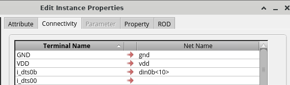

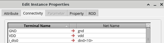

    Hi Andrew, I've added your suggestions. What I was doing before was walking the cell properties and editing terminals and labels. I'm fairly certain the navigator issue is a visual bug, as I created a procedure to walk through a cells properties, and find occurrences of a string, and there are no old tags.
    A more pressing issue I've now met, is the layout case. When I switch terminal names, it is reassigning my net to nil. See the before and after of renaming i_dts0 to i_dts00:
    I've referred to an older article concerning renaming the layout pins, and the flow follows as such:
    dbOpenCellViewByType - layout
    dbFindTermByName - old pin name
    term~>name = newName
    walk the figs~>children hierarchy and update old labels
    I'm wondering what I'm missing as to preserve the connected value of i_dts0 when it changes to i_dts00.
    EDIT: This is performed on Layout EXL, IC23.1.
    Thanks, Trevor
    Andrew Beckett 6 months ago in reply to Trevor F
    Assuming you are talking about what happens to the connectivity in the layout containing an instance of your cell for which you have changed the terminal names, you'd need to get it to reconstruct and reconnect the instTerms. Typically this would be done using Update Components and Nets (presumably the schematic connectivity has changed, and the layout connectivity needs to update to reflect that). I think the extractor would take care of it after that (so I don't think an explicit re-extract would be necessary), but using UCN would be the sensible way to update the connectivity correctly.
    Changing the terminals on a device/cell does not alter the instTerms on the level above (same as in a schematic, which is why the schCheck was needed).
