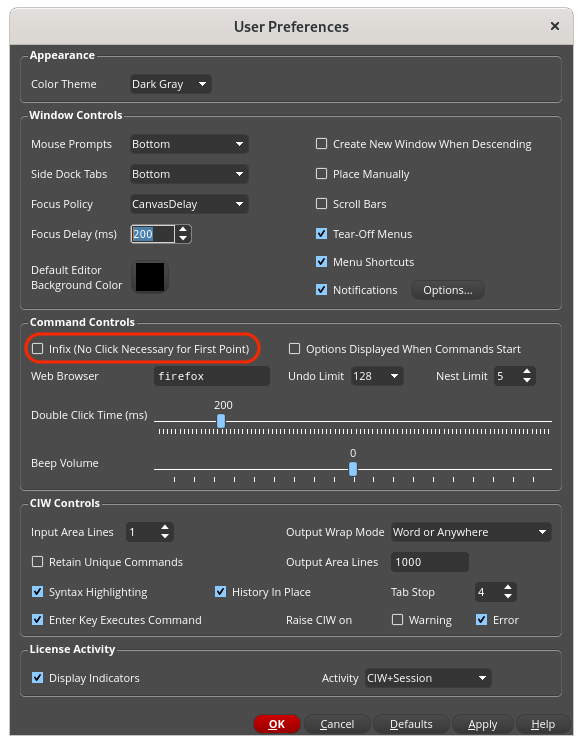

When I hover my cursor on an object in the schematic and press "c" to copy it, I have to click once to select the object, or provide a reference point, and then click a second time at the destination.
Is there a way to save the 1st click, and just use my cursor location when I press the "c" button?
I tried to add schSingleSelectPt() after schHiCopy(), it still asks me to click left button twice.
Is there a skill function that does the mouse click?
Thanks!
    Andrew Beckett 6 months ago
    There is a setting called infix which does exactly this. It's in Options→User Preferences in the CIW (it needs to be on, i.e. checked, to get the behaviour you want):
    This can also be set in the .cdsinit using:
    envSetVal("ui" "infix" 'boolean t)
  • gangliurfic
    gangliurfic 6 months ago in reply to Andrew Beckett
    Thank you Andrew! problem solved Slight smile
