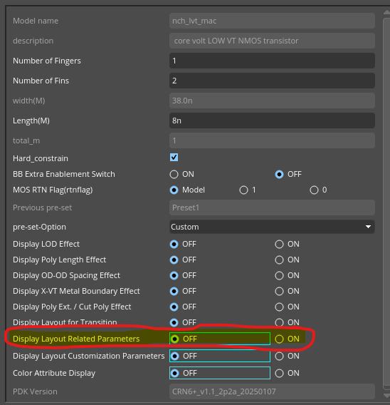

Hi, How to hide a set of parameter section in pcell generation using "pcDefinePCell()" fuction. Can anyone help?
Just like this.
    Andrew Beckett 3 months ago
    You need to define CDF for the cell; then you can control the editable and display callbacks to control whether a particular parameter is displayed or not.
