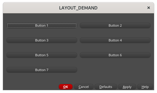

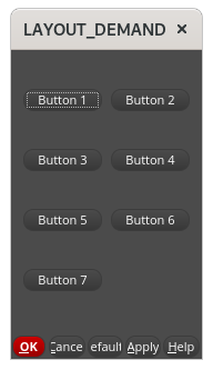

    I don't seem to be able to post my example code which showed this (since your code was not complete), but everything seems to work fine. As I make the form bigger:
    Then smaller:
    Then smaller again:
    Once the buttons reach their minimum size (to display the buttonText) they don't get any smaller (despite the minimum column width) and scrollbars appear instead. I would not expect the button text to get clipped.
    This all seems reasonable to me.

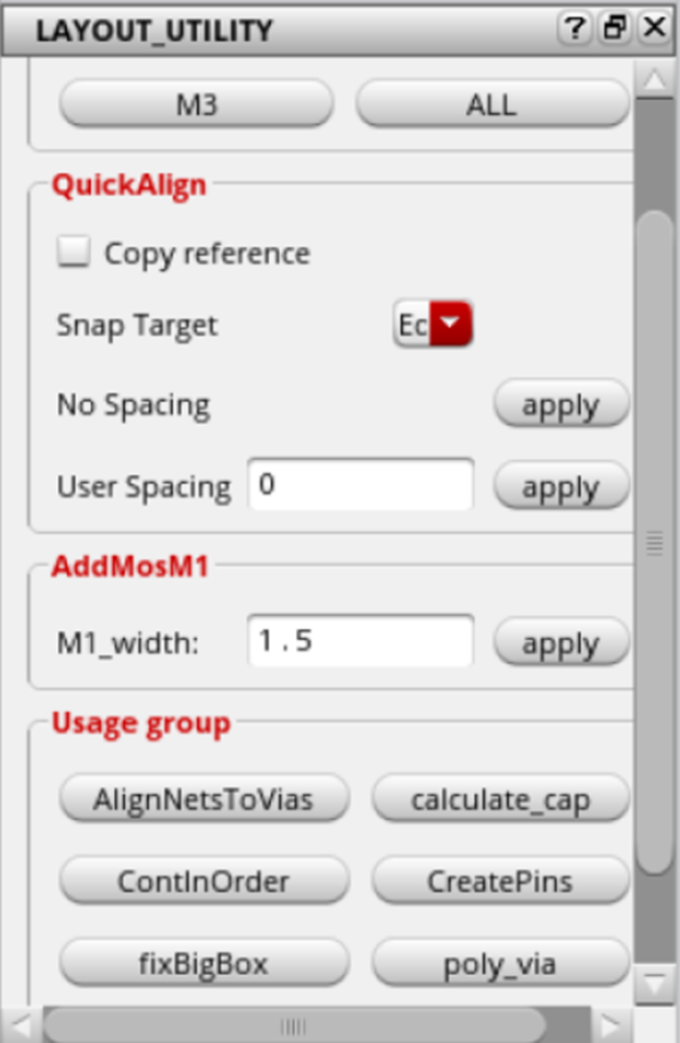

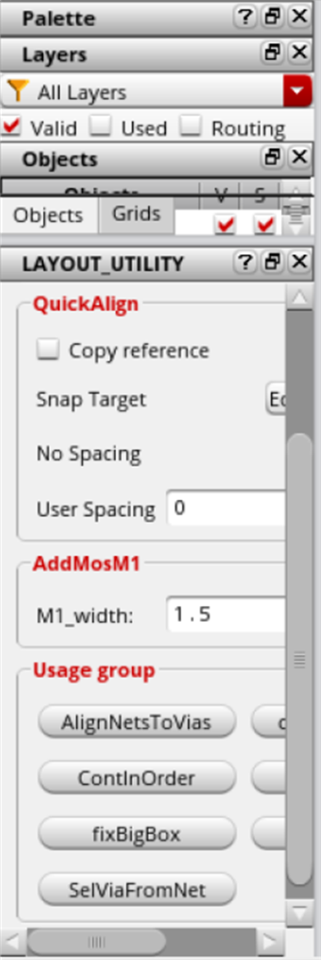

    Figure 1 shows the form fully displayed after stretching the window to the right.
    Figure 2 shows the form as it appears right after loading.
    My apologies — I should have shown the complete form to avoid confusion. As you can see in Figure 1 and Figure 2, my expectation is that all fields would be fully visible immediately upon‑loading (like Figure 2). What actually happens is I have to drag the right border of the form to reveal all fields (as shown in Figure 1). I suspect this behavior may be related to the presence of cycle‑field and string‑field widgets.
    Andrew Beckett 2 months ago in reply to SZ20260803361
    This was recently discussed in How to get the size of a custom dockable window. There's a link to an article in that thread that gives a (rather clunky) workaround. As I advised in that thread, you might want to contact customer support and ask for a duplicate of the CCR to be filed on your behalf to increase the visibility and hopefully the priority.
