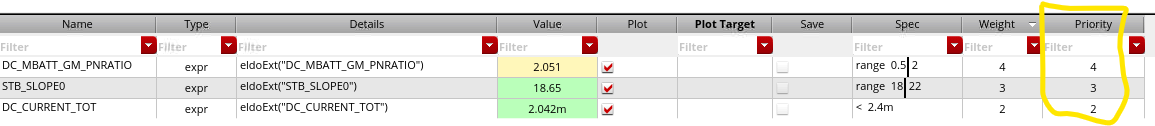

Is there any way to get the priority of ADE outputs?
The weight can be accessed with the function axlgetSpecWeight but I can not find an equivalent function for priority.

    Hi Laurent,
    Apologies - I didn't see this post (I think there may have been a problem with notifications for a while - I should go back and look for anything I missed).
    As far as I can see there is no public function for this. Even the maeSetSpec doesn't have the option to set it - but we probably ought to have an maeGetSpec function to retrieve this kind of information. Please contact customer support and request this as an enhancement.

    kkdesbois 1 month ago in reply to Andrew Beckett
    Thanks for the confirmation. Case created.
