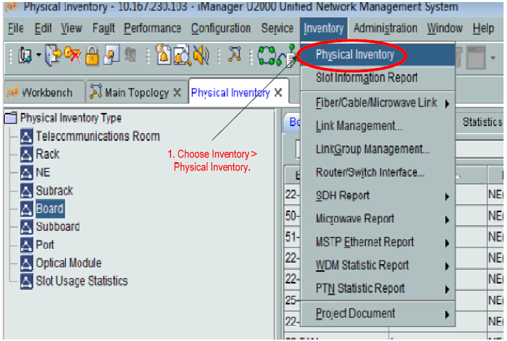

1. On the main menu, choose Inventory > Physical Inventory.
1.Physical Inventory

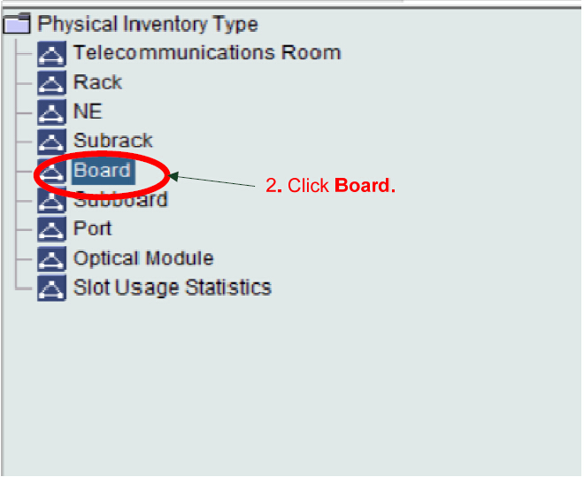

2. Under Physical Inventory Type, click Board.
2,click board

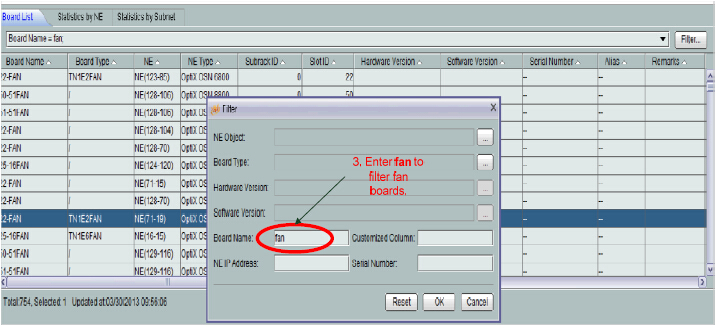

3. On the Board List tab, click Filter. In the Filter dialog box that is displayed, enter fan in Board Name to filter fan boards. Then click OK.
3.click filter

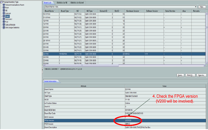

4. In the window that displays the filter result, view the FPGA version information.
4.check the FPGA version
If the FPGA version is V200, go to the next step.

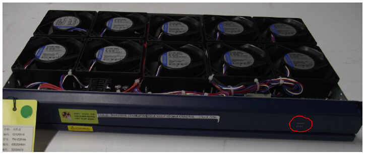

Step 4 At the equipment room, check the indicator status on the fan tray assembly. The highlight in the following figure shows the indicator position. If the indicator blinks red and green alternatively, and the fans speed up when it blinks red and restore to the normal speed when it blinks green, the fan tray assembly is involved in the problem.
check the indicator
